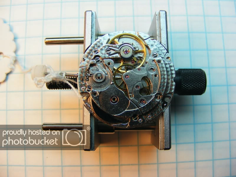

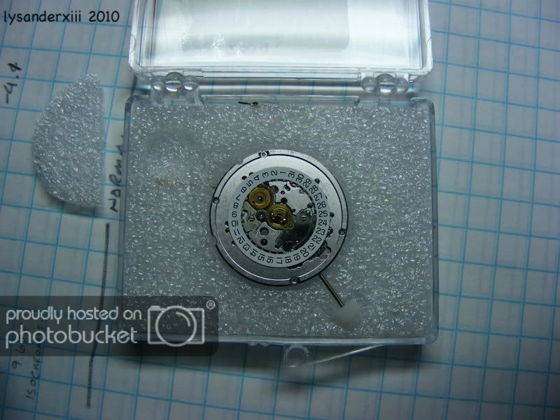

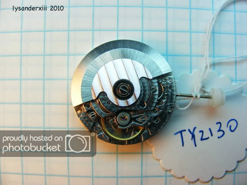

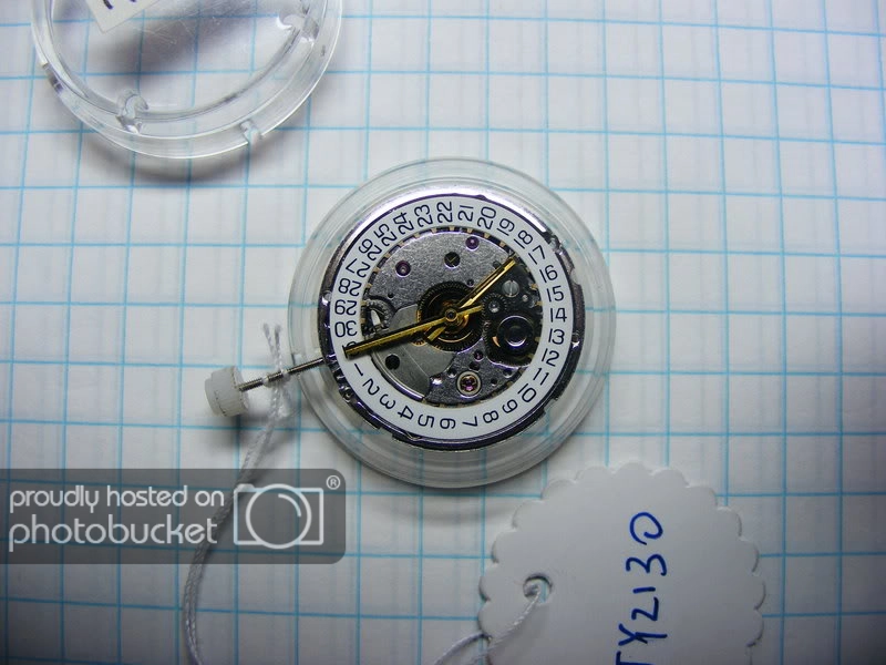

Seagull TY2130

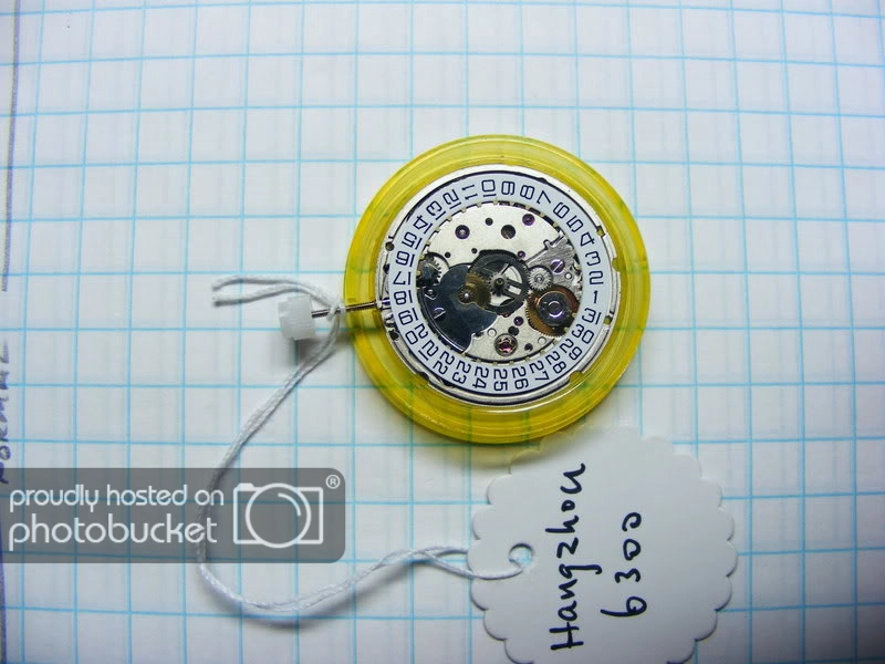

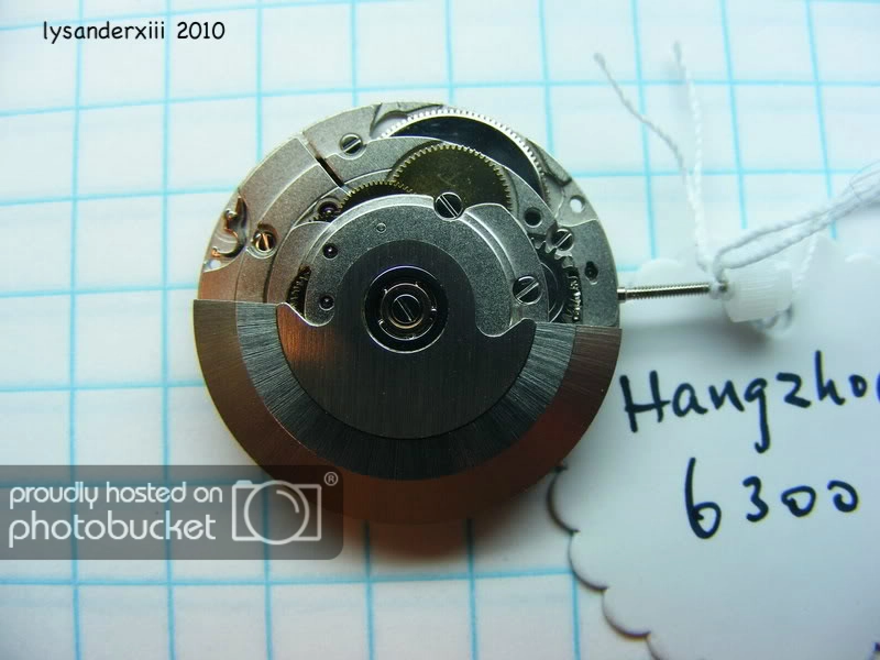

Hangzhou HZ6300

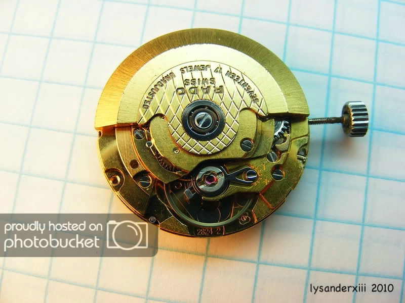

ETA 2824-2
TY2130, HZ6300 and ETA 2824-2
Type: Automatic mechanical lever movement
Size: 25.60 mm (26.00 mm overall) x 4.60 mm
Frequency: 4 Hz (28,800 bph)
Analog three hand display with quick change date, three position winding/setting stem.
The ETA is a Standard grade with a gold plated nickel balance and Nivarox 2 balance spring, I do not know what material the Seagull and Hangzhou are using.

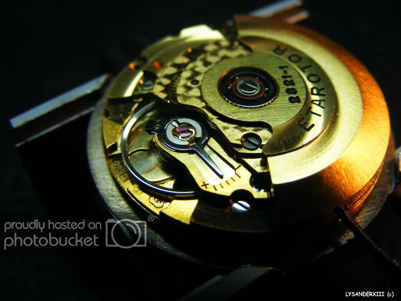

ETA 2004-1
ETA 2004-1
Type: Automatic mechanical lever movement (uni-directional winding)
Size: 23.30 mm (23.90 mm overall) x 3.60 mm
This is a Top grade ETA with a gold plated Glucydur balance and Anachron balance spring.
The TY2130 and the HZ6300 were taken directly from the package, wound and placed on a Mumford MicroSet Watch Timer. Then after running (movements motionless) for 24 hours, the rate (CH only) was taken again to establish the Isochronism.
The initial results were as follows:
TY2130:
Beat error: 0.3 ms
Rate, CH (dial up): -4.8 seconds per day
Rate, 9H (crown down): +0.6 s/d
Isochronism: +9.6 s/d
HZ6300:
Beat error: 0.1 ms
Rate, CH: +15.2 s/d
Rate, 9H: +11.7 s/d
Isochronism: -3.5 s/d

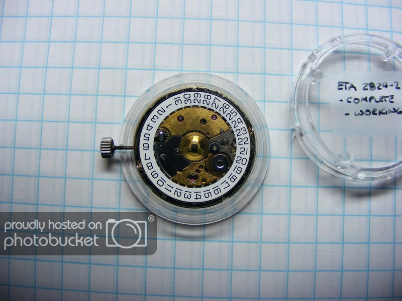

ETA 2824-2 (Rado, recently serviced):
Beat error: 0.2 ms
Rate, CH: +2.7 s/d
Rate, 9H: +2.0 s/d
Isochronism: -8.2 s/d
ETA 2004-1 (loose, recently serviced):
Beat error: 0.0 ms
Rate, CH: +3.4 s/d
Rate, 9H: -3.4 s/d
Isochronism: -7.5 s/d

Note on the finish of the movements, The Rado ETA 2824-2 is plain gold plate with a very simple pattern on the rotor, the HZ6300 is plain nickel plate with absolutely no decoration. The TY2130 is finished in a manner similar to the ETA 2004-1 with a fine nickel plate and pearlage on the visible plates and Cote-de-Geneve on the rotor. From a strict utilitarian point of view, nickel plating is the best finish, but is slightly more expensive than gold plate due to the cost of handling the chemical waste associated with nickel plating. Also, pearlage and other decorations show up better on nickel plating.

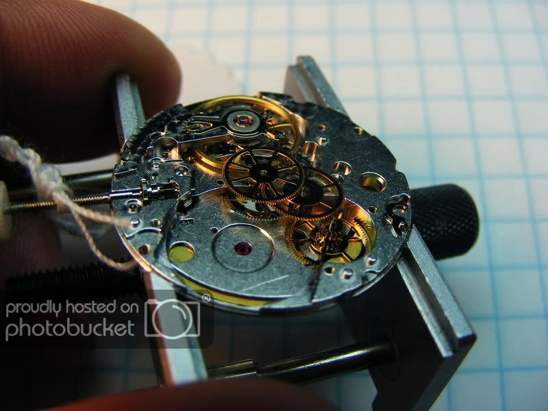

Part two: a) Tear-down
The disassembly of the TY2130 and the HZ6300 is straight forward, and thanks to the design, there aren't many little springs to go flying (only one, in fact, the click spring, all of the other springs are integral with a larger part). This part will just show pictures the teardown of one sample, as two of the others will be the same and the teardown of the 2004-1 is not relevant to the thread.

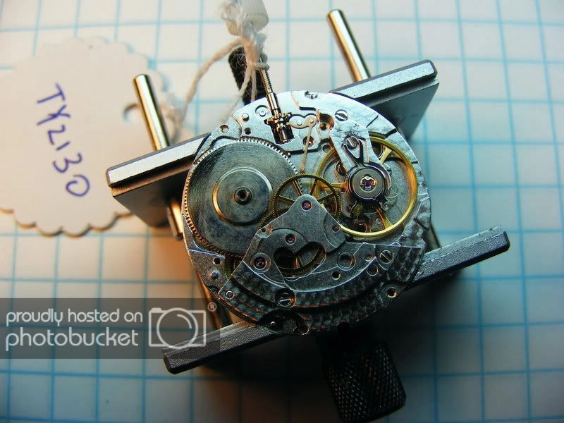

I find it easiest to start from the back and work forward. This portion will show the TY2130. First the rotor is removed.
Then the two black screws for the autowinding bridge are removed, and carefully lift it off. After the autowinding bridge is removed, the Mainspring is let down, then the ratchet wheel, crown wheel, click and click spring are removed from the barrel bridge.
Now, the barrel bridge is removed. We can see the placement of the balance stop (hack) lever.

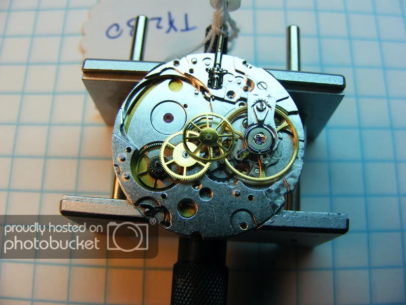

And then the train bridge comes off. Two views of the gear train.
Then the balance and pallet fork come off.

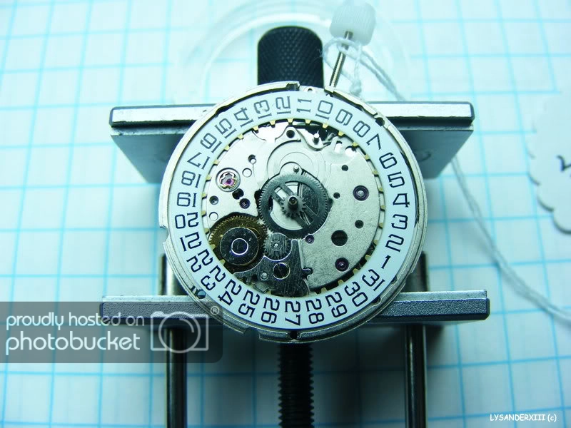

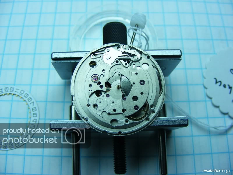

On the dial side, (this is the HZ6300) the minute train bridge is removed. The hour wheel, minute wheel, setting wheel, date corrector are removed.
Then the rest of the calendar mechanism can be removed along with the cannon pinion.

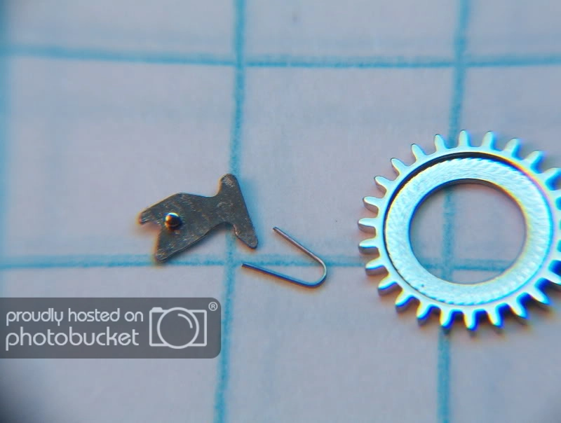

We mentioned the one loose spring in these movements, here it is, the click spring, along with the click and crown wheel.

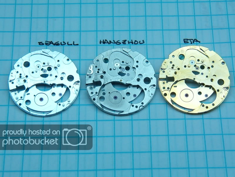

Found something interesting already.

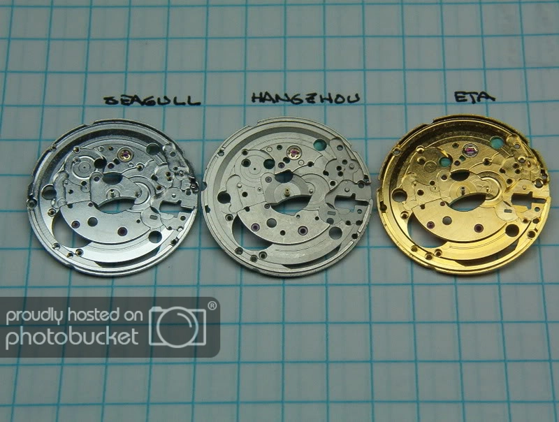

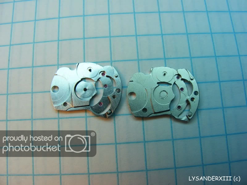

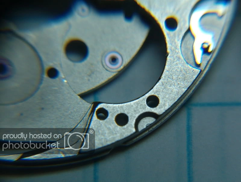

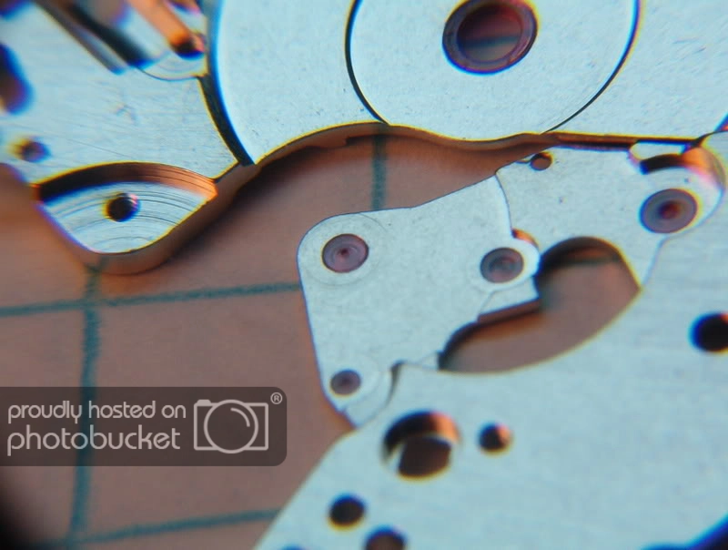

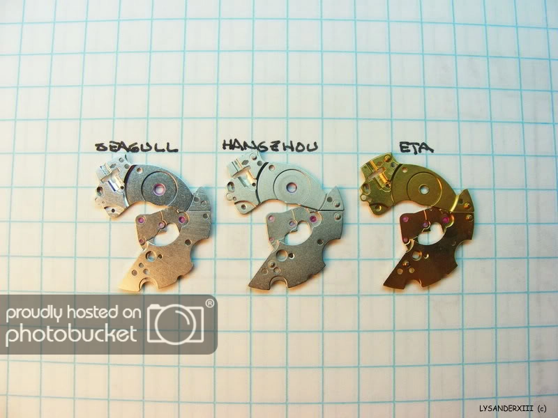

Here are comparison shots of the three mainplates, see if you can spot the one that is different.
Back:
Front:

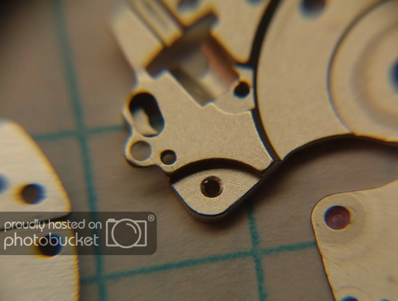

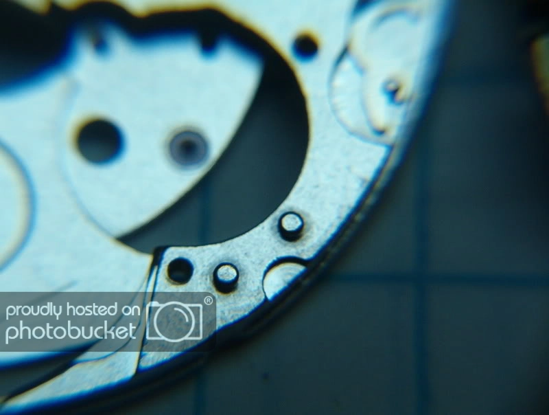

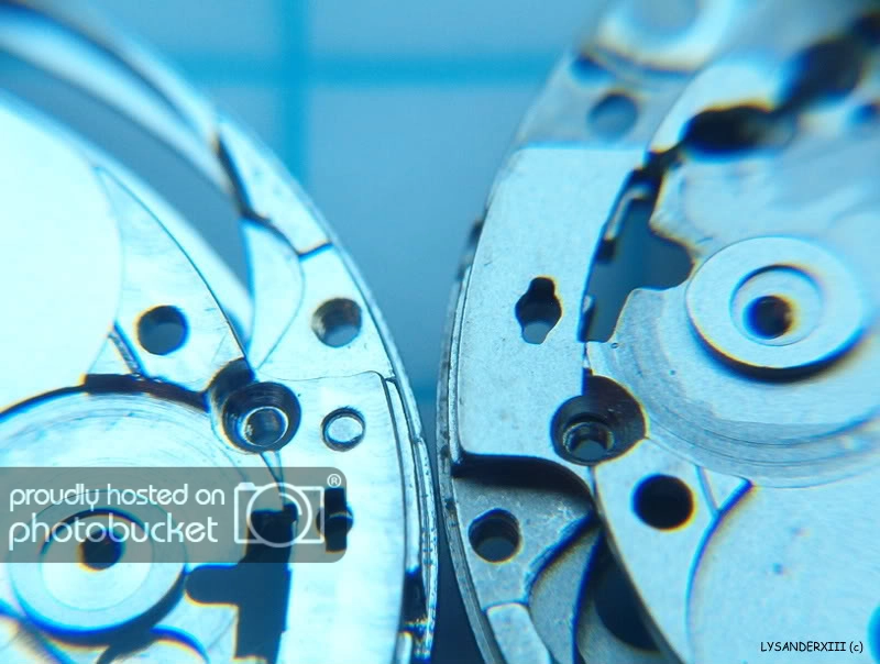

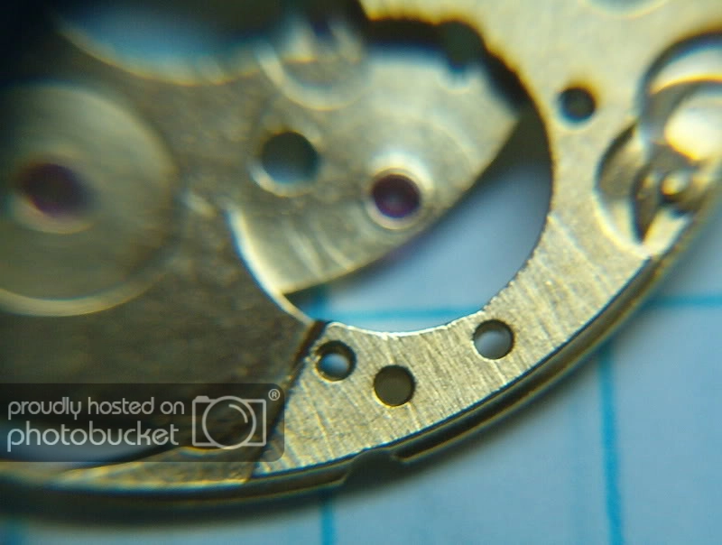

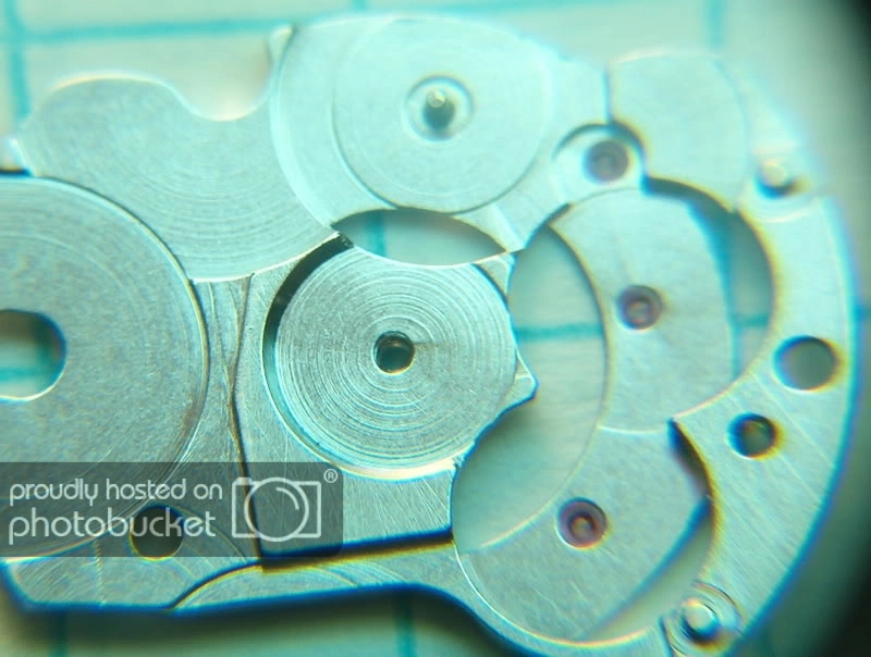

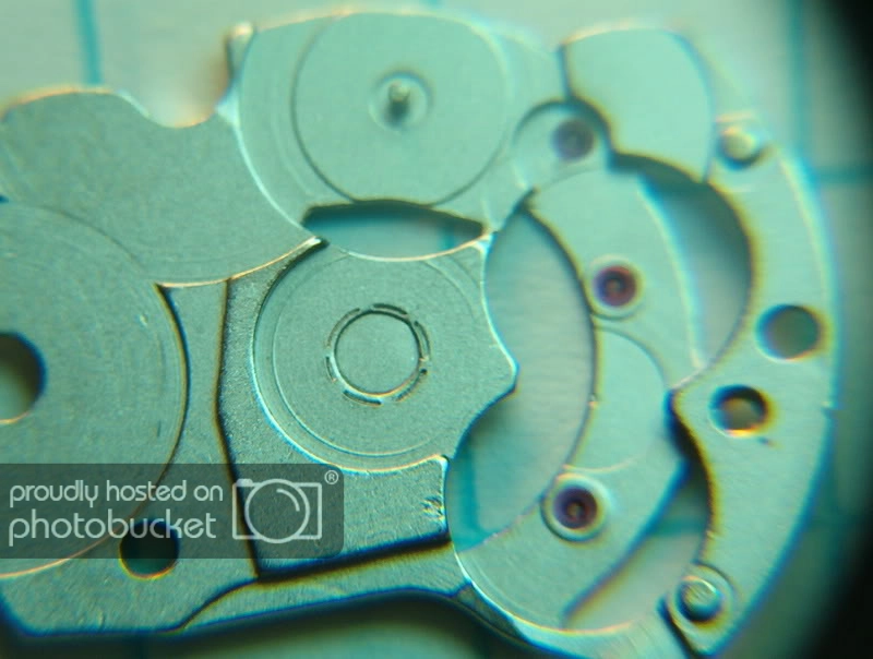

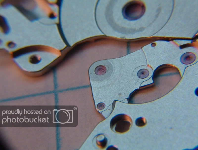

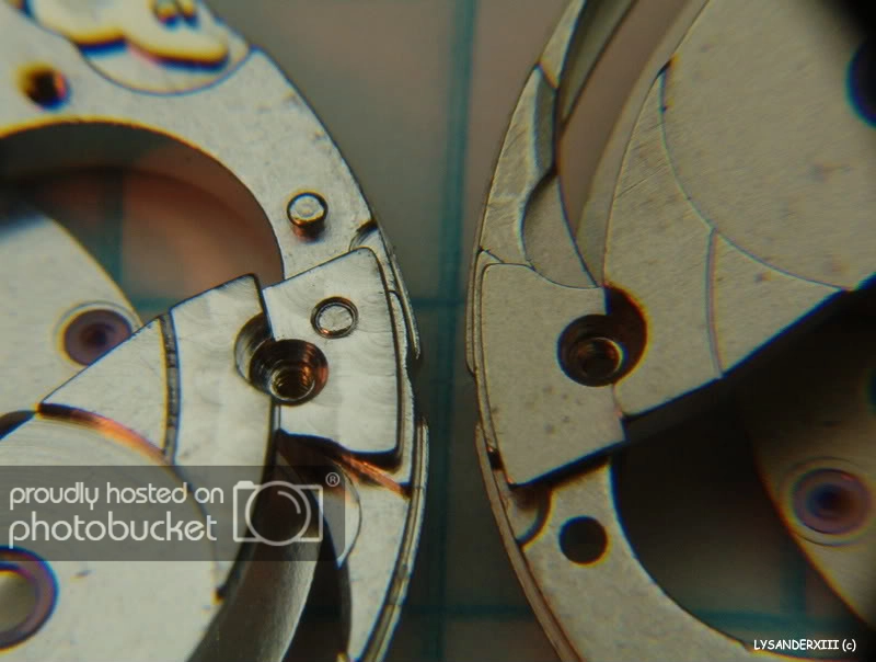

The major difference is how how the bridges are aligned to the main plate. Here are detail shots of the differences. The Hangzhou and ETA use holes in the mainplate and trepanned studs on the bridges, the Seagull uses holes in the bridges and holes with pins in the mainplate. The Seagull uses the method favored by Selitta in the SW200, except for the balance bridge, where Seagull uses the ETA method.
Seagull:
Hangzhou:
ETA:
Why do I find this interesting?
Putting pins in holes and controlling accuracy to a few hundredths of a millimeter is a hell of a lot easier than trepanning a stud, and saves material. The stock material for a trepanned stud must start out with sufficient material to allow for the stud to be cut out.
The Hangzhou also does have a few additional holes drilled in it, but all of these hole are non-functional, either pilot holes for a day/date mainplate, or additional holes for oiling and/or inspection.
One other thing that is not readily apparent in the long range shots above is the Seagull was completely devoid of any oil. The Hangzhou was well oiled.
Seagull jewels, no oil:
Hangzhou, note the oild bead on the jewels and the oil spread discoloring the plate:

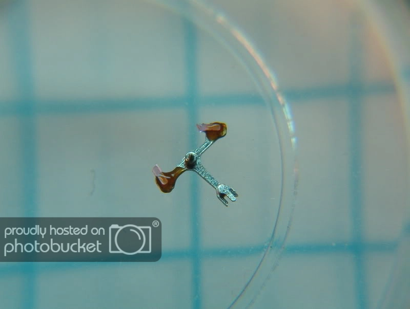

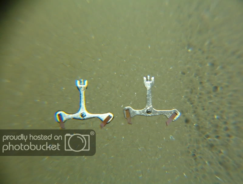

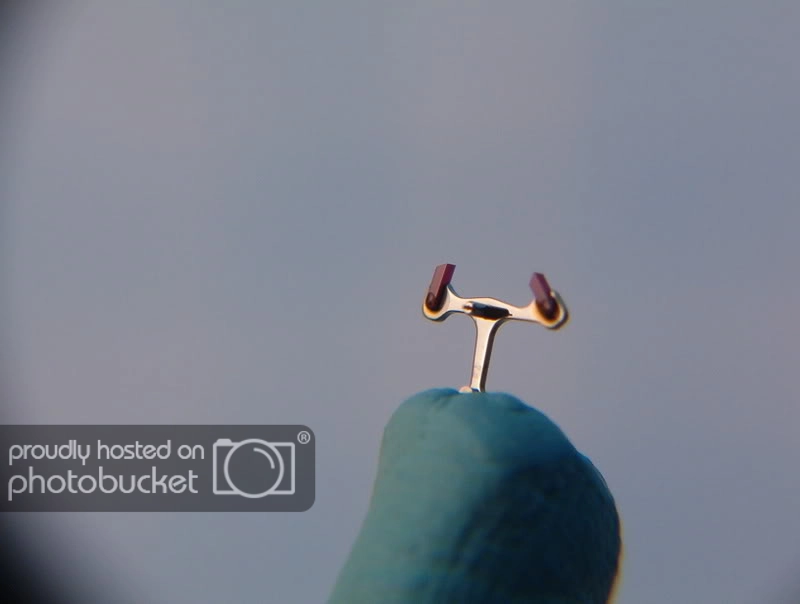

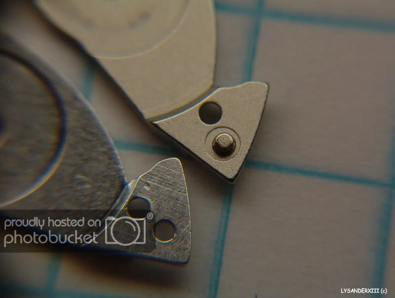

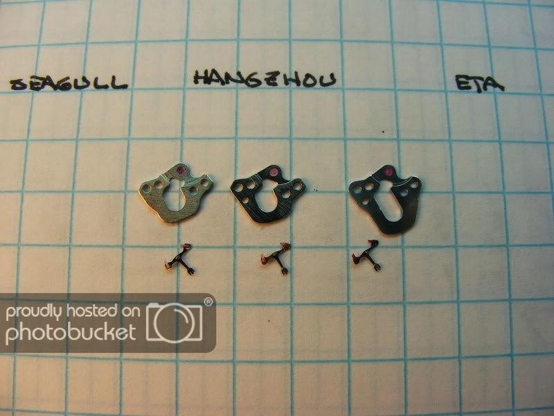

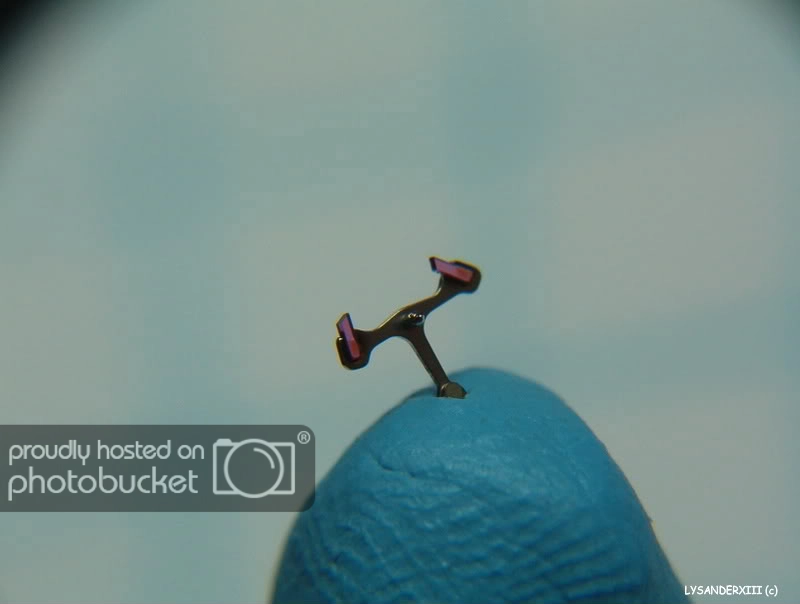

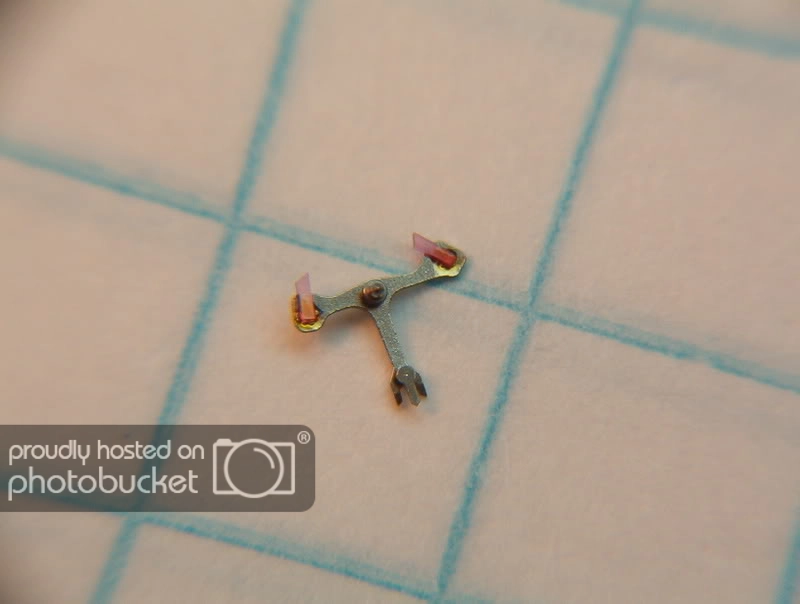

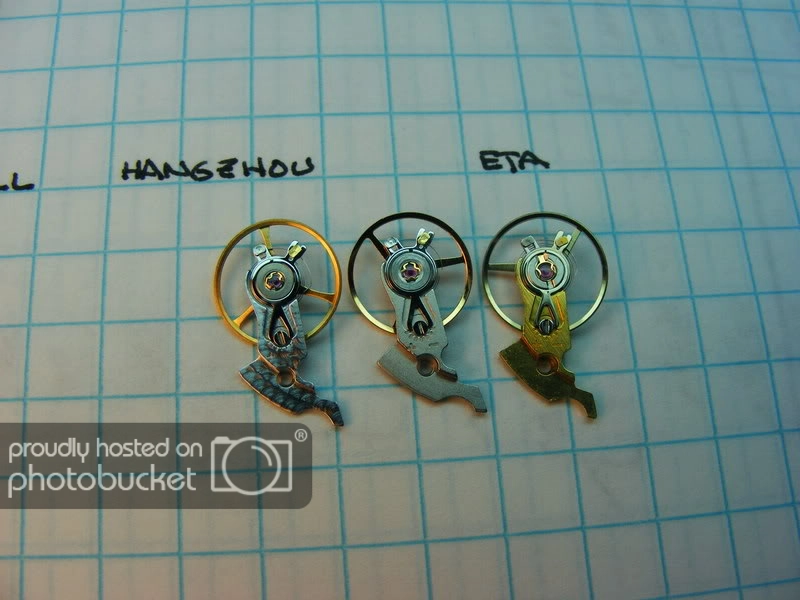

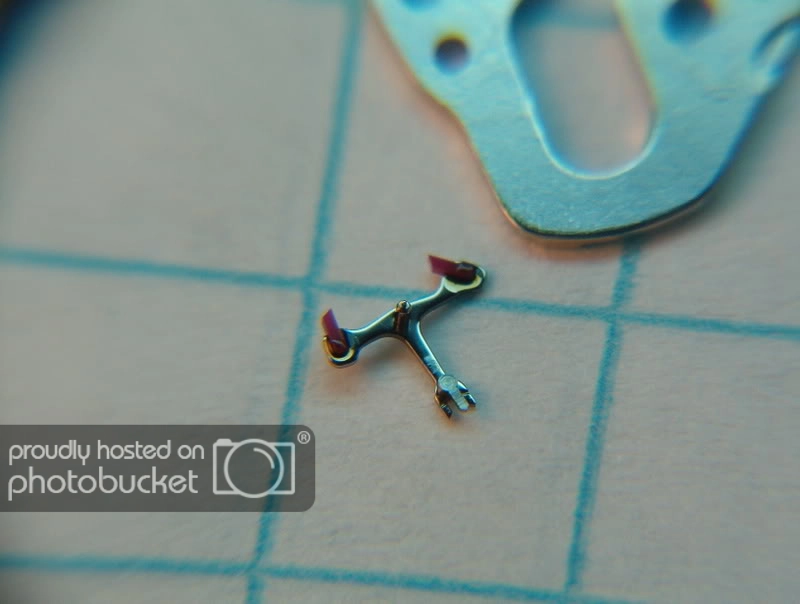

The pallet fork:
Seagull:
Hangzhou:
ETA 2824:
ETA 2004:
The two ETAs certainly use less shellac on the pallet stones. The Seagull seems to have allowed some bubbles as well.

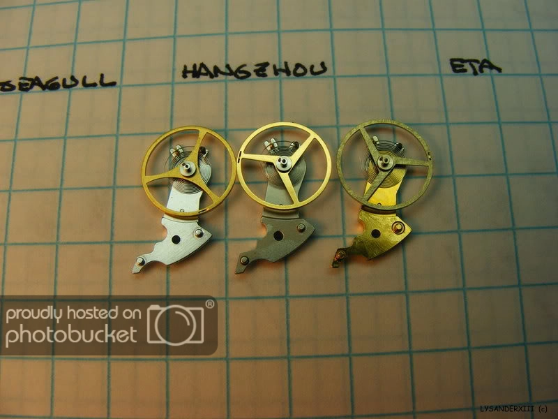

Balance and balance cock:
BalanceandBalanceCock-back_zps26412e90.j

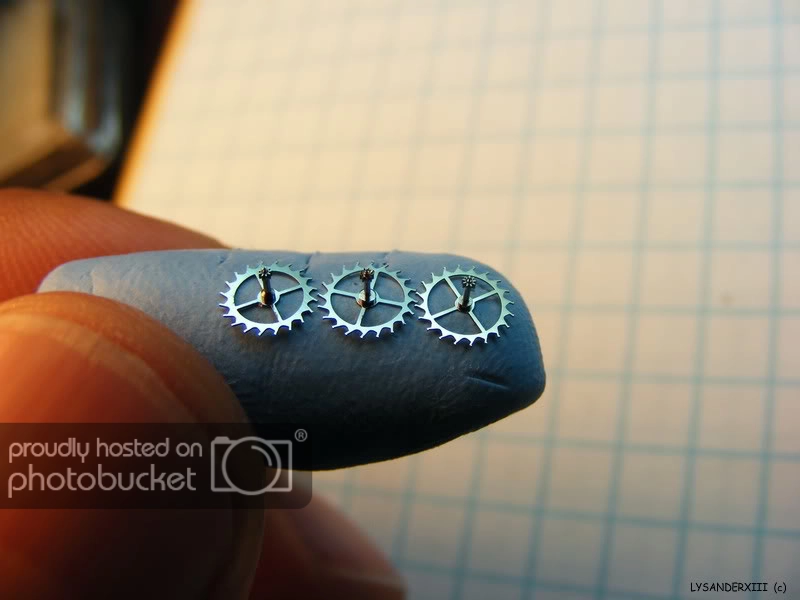

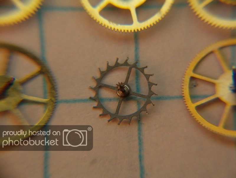

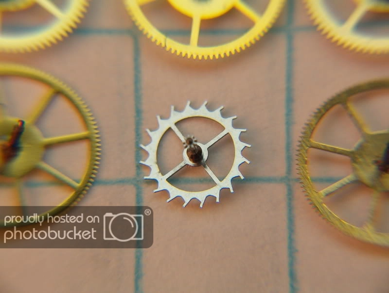

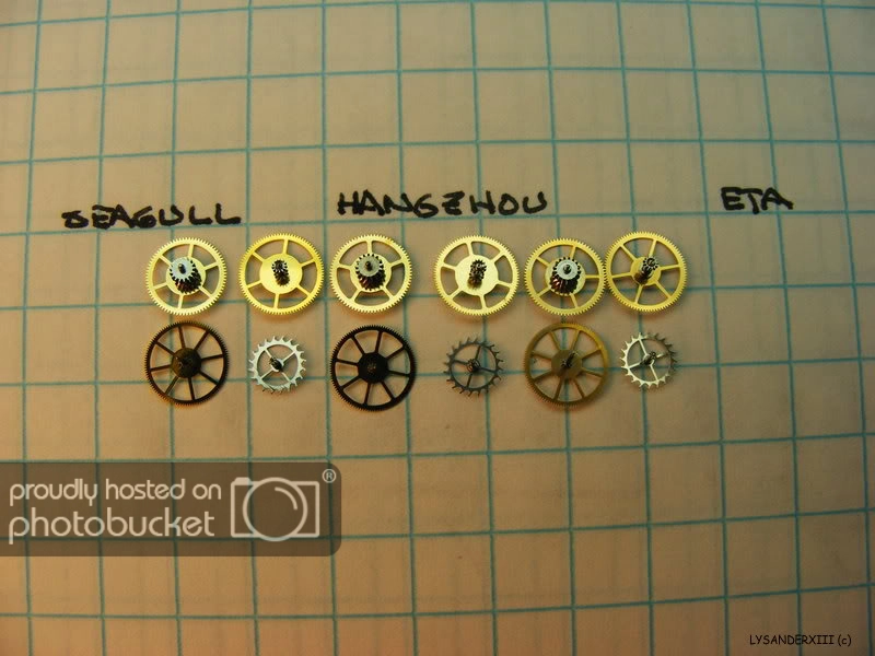

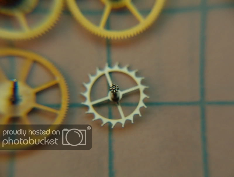

Escape wheel:
Seagull:
Hangzhou:
ETA:
Train wheels:

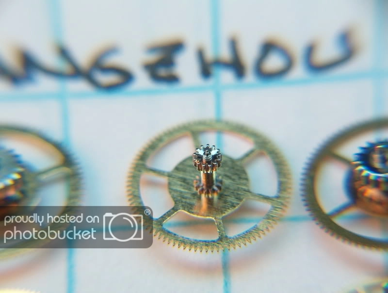

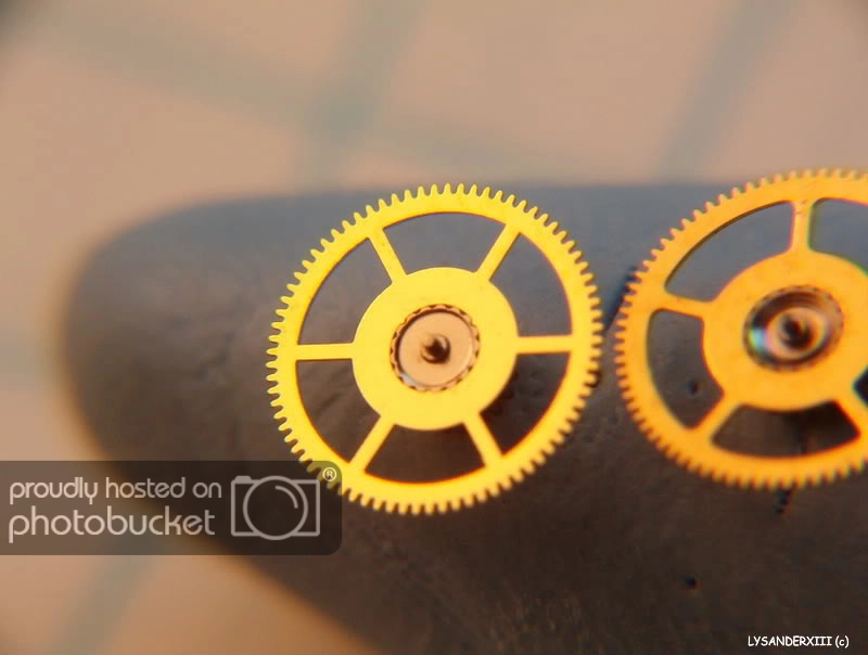

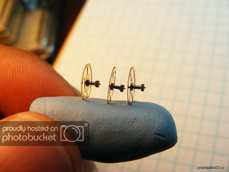

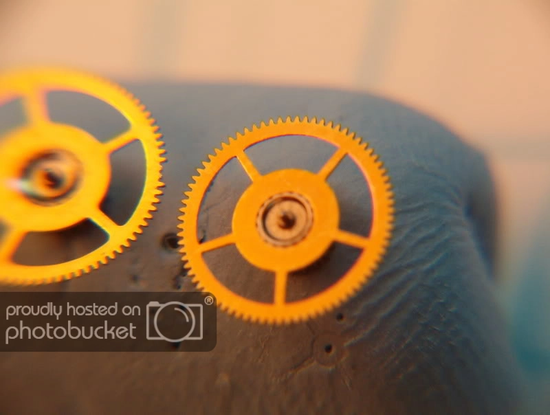

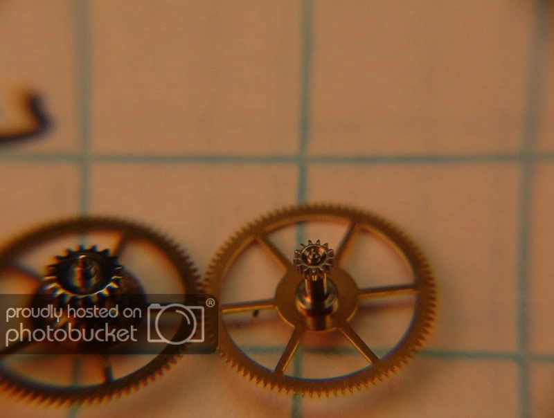

Seagull center wheel:
Hangzhou center wheel:
ETA center wheel:

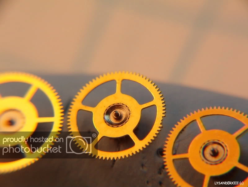

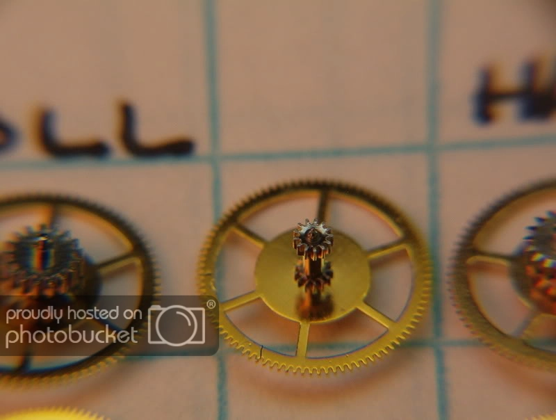

Close-up of the third wheel:
More 3rd wheels:
Seagull:
Hangzhou:
ETA:

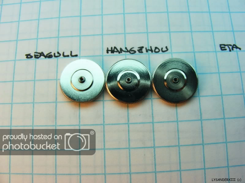

Barrel:

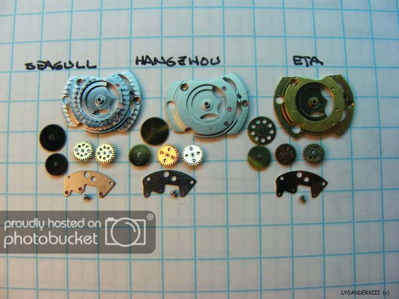

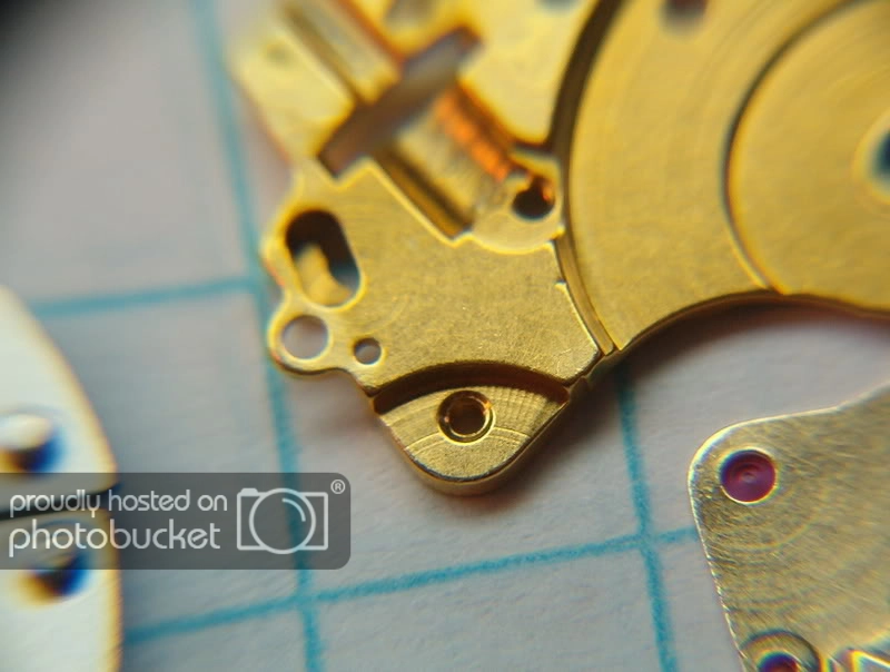

Barrel and train bridges:
Autowind bridge (disassembled):

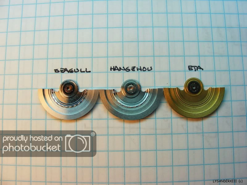

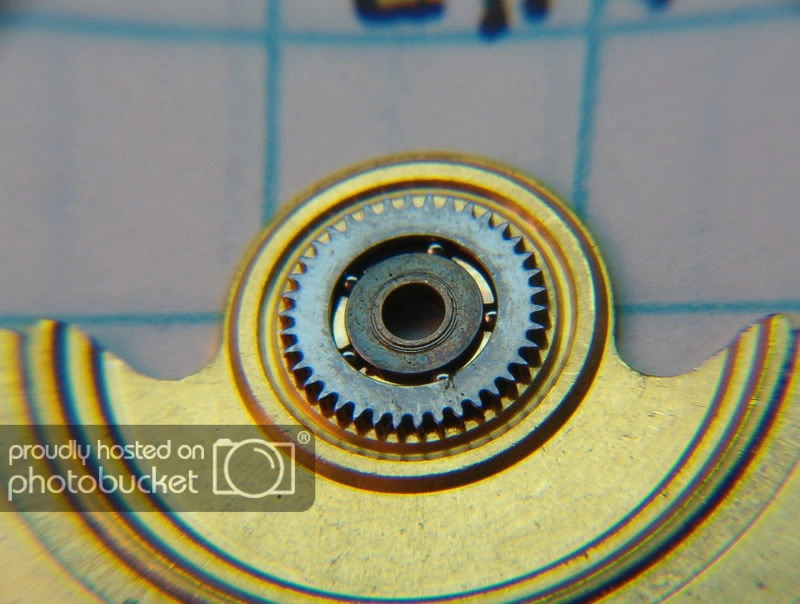

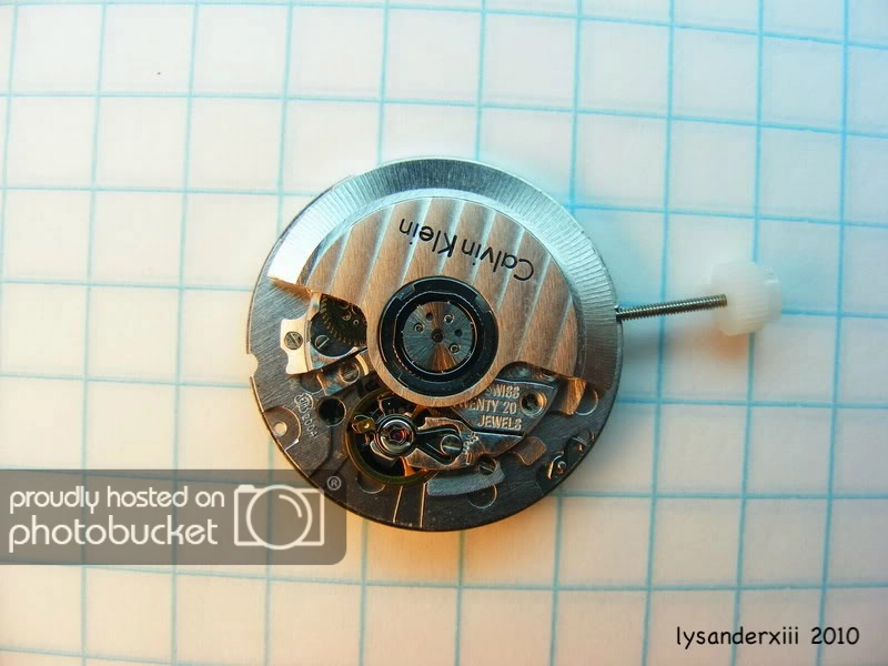

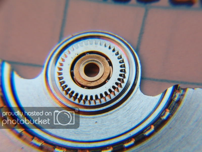

Rotors:

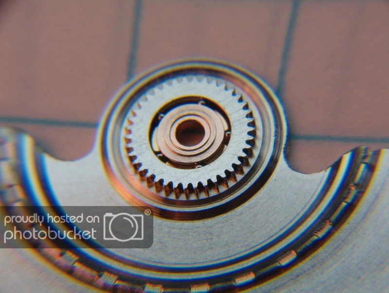

Rotor center gear and bearing:
Seagull:
SeagullRotorCenterGearandBearing_zpscf4e
Hangzhou:
HangzhouRotorCenterGearandBearing_zps97a
ETA:
ETARotorCenterGearandBearing_zps0b7a897b

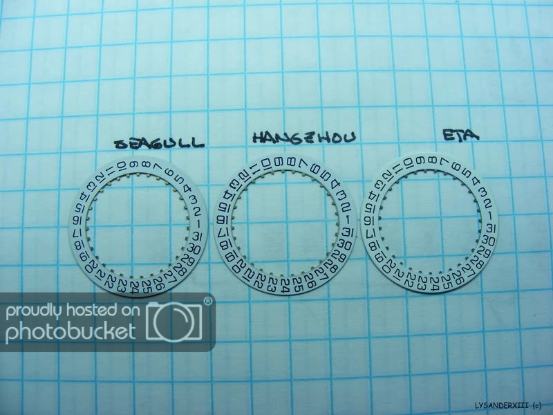

Date wheel:

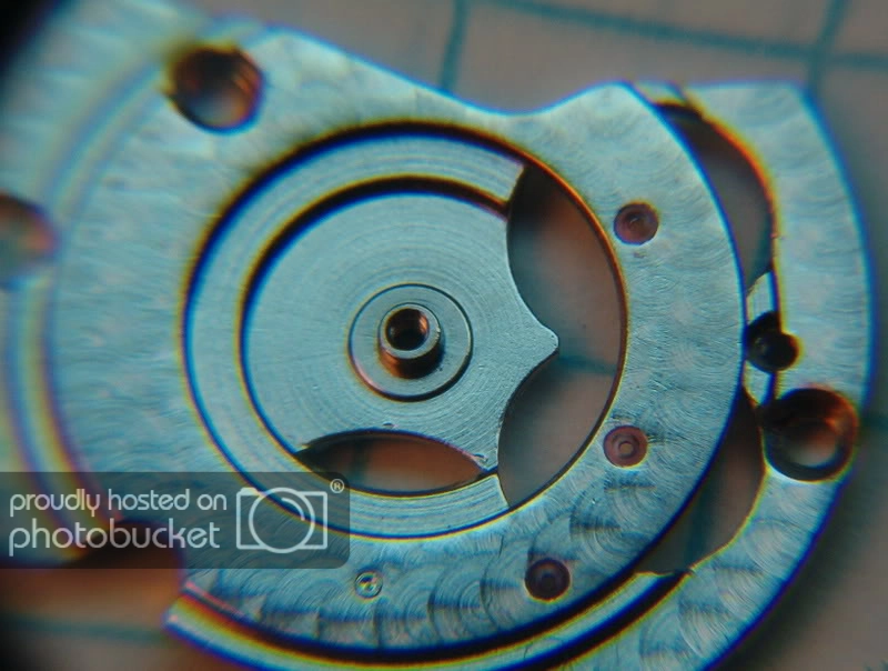

Close-up of the Seagull autowind bridge rotor axle:
SeagullAutowindBridgeRotorAxle_zps58d684
Same shot of the Hangzhou:
HangzhouAutowindBridgeRotorAxle_zpse7d0a
Just a shot of the same place on the underside of the three movements:
Seagull:
Hangzhou:
ETA:
The rest of the story is told from the back side of the autowind bridge: (Seagull on the left, as usual, ETA not shown, as it is the same as the Hangzhou, except for three jewels)
Close-up, Seagull:
SeagullAutowindBridgeBackSide_zps81dec71
Close-up, Hangzhou:
HangzhouAutowindBridgeBackSide_zps56e4bb

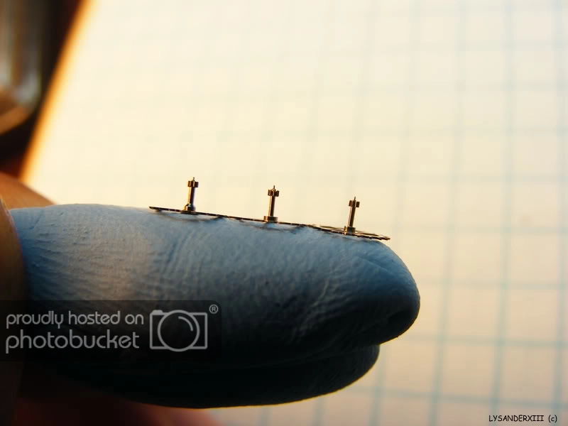

The original design for the autowind bridge is that the rotor post be a separate part staked into the bridge. This was probably done so at some point the post could be removed (the autowind bridge design is shared with other movements without ball bearing rotor). However, the current application with only a ball bearing rotor and no relative motion the post, this is a superfluous requirement. So, Seagull simplified the design to eliminate one part and three manufacturing operations
Aside from the unsightlyness of the off-center hole, it really has no influence on the operation of the rotor, the screw that goes in the hole is only there to retain the inner bearing race.
And, just as a point of reference, although it looks huge in the picture the screw hole is only off-center by 0.044 mm (or 0.0017 inches, for US.)
Part four - Assessment
I am not a Swissphile, most of the work I do is on stuff that professional watchmakers don’t have the time or inclination to do, which leads to a lot of Chinese and Japanese stuff and the low end vintage junk. So, I feel I am well acquainted with what the Far East can offer.
With that preface, I will say this of the three 2824-2 we looked at, the ETA is the best of the three. The Rado was a NOS from the mid to late 1980's, and aside from the lower jewel count is just as good as the ones produced today.
Does this mean the other two are inferior movements?
Hardly, the deciding factors are not in the functional areas, but in the areas that are done because that is how you make a quality product, cleaning up the unseen and well as the seen.

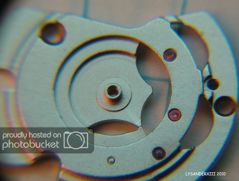

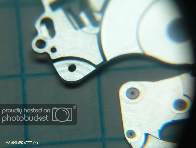

The Hangzhou is the better of the remaining two, in terms of workmanship. If you look at these two pictures:
You will note that the underside of the screw hole is properly chamfered on the Hangzhou, while the Seagull it is not. This is typical of the work on the under side of all parts of the Seagull. The overall finish of the plates in general is better on the Hangzhou, there is an absence of tooling marks and tooling chatter.
Chatter and tooling marks on the Seagull (left).
Cleaning up little things like the pallet fork (Hangzhou - right)

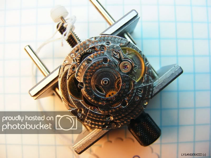

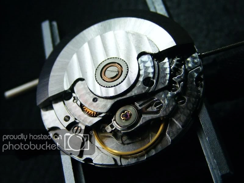

Also, while reassembling these movements, I noticed that the pictures in this thread are not really representative of the movements. After all, showing something at 12x larger than life tends to show the worst side.
Take the pictures of the pallet forks (below for reference) these look like they have a 16 finish on them and were made by a cave man with a cold chisel and a hammer. The reality is they are nice shiney little parts, maybe not as shiny as the ETA, but quite well made.

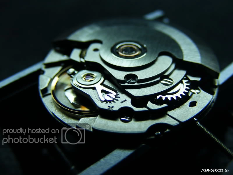

At 12x, the beauty of the decorative finish is also lost. The pearlage on the autowinding bridge on the Seagull looks quite poor when enlarged, at 1x, it is a very nice job that they did.
With better composition and lighting, we can show thes little beauties in all their glory. Something like this ETA 2821-1 is easily their equal:

Two shots to better show the quality of the finish.
The TY2130
HZ6300
